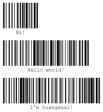

<html>
<head>
<script src="jquery-2.1.1.min.js"></script>
<script src="JsBarcode.all.js"></script>
</head>
<body>
<svg id="svg_barcode"></svg>
<!-- or -->
<canvas id="canvas_barcode"></canvas>
<!-- or -->
<img id="img_barcode"/>
<script>
$("#svg_barcode").JsBarcode('Hi!');  //或 JsBarcode("#svg_barcode", "Hi!");
$("#canvas_barcode").JsBarcode('Hello world!');  // JsBarcode("#canvas_barcode", "Hello world!");
$("#img_barcode").JsBarcode("I'm huangenai!");  // JsBarcode("#img_barcode", "I'm bwju!");
</script>
</body>
</html>
